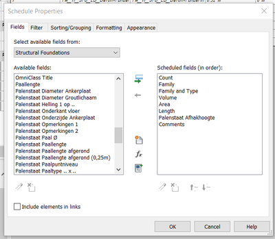

Goodday,
I've searched for a solution on the forum but i couldn't find any. so here is my problem:
I have lots of schedulable parameters in my structural foundation category. I would like to edit the name and use them in structural foundation families so i can add values to parameters which will then show up in the schedule. But i can't find a way to add a parameter from the available fields list into a family.
My other solution (which seems a lot of work) is to clean up de schedulable fields by deleting most of the parameters. Then add shared parameters to the family which will then be schedulable (this is quite simple). But then again, i can't find a way to delete the parameters listed in de available fields.
Any help is welcome 🙂

You can add Project Parameters to System Family Categories. Is that not what you want to do?
...you can't delete System Parameters, but you don't have to include them in a Schedule either.
