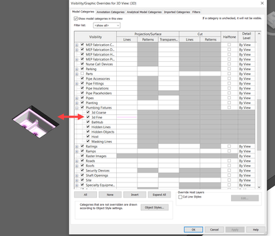

I downloaded a 3d sink from the manufacturer (Kohler). In 3d, when I hide contour lines, it looks fine, but in plan the contour lines are purple, and unfortunately when I print to PDF they stay purple. Does anyone know how I can make them print to pdf in black? When I open the family it won't let me modify it (can't even select the object).

Post the family.
How about a Kohler Tub instead?
Your family might have been created in AutoCAD.  If so, change these in Object Styles, under Imported Objects.
L.S.
L.S.
Thank you Tim, but I looked in imported objects and it's not there.
 So, are you unable to change these line colors?
L.S.
Thank you @barthbradley that worked
