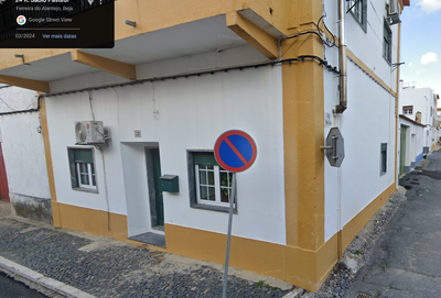

Hey!
I'm new to Revit and 1) I'm trying to create someting like the above image, where the corner is a different color from its wall. What's the best way to do it? Should I just duplicate the wall type and change its color?
2) What if I wanted that corner to have more depth on the outside? In other words, it would extrude out.
Thanks!

You can add vertical wall sweep, an architectural column (then paint surfaces), a model in place component....

I would model using walls and columns, with customized material surface patterns or even just using the paint tool

Could you explain better the walls with customised material surface patterns? Thanks!

With the vertical wall sweep there's a gap between the two perpendicular walls; I couldn't really work with the columns; the model in place doesn't move if I do chances to the model but seems to be the one that works the best assuming I don't change my project m

Yes. I'm referring to the Material Manager, where you can assign a surface pattern to your materials and then apply them to walls and columns. You can see "material" parameter when you select one of them, then choose the previous edited material. 🙂

For whoever lands here in the future,
As suggested above, I ended up addin a column. However, I had to make my own costum column family. It looks like this (floor view):
I then changed its material to the desired one.
To make your own column family go to File > New > Family > Metric Column.
You then add an extrusion and do it the way you desire.
This is how the final product looks:

That is actually a beam beneath a column. The classification (open BIM) would be incorrect. I am glad you got what you needed but i would model them separately.

What do you mean by a beam beneath a column and modelling them separately?

Never mind. After a closer look, it seems like it's a thin wall, possibly painted or something similar. However, I still wouldn't use just a single column.
