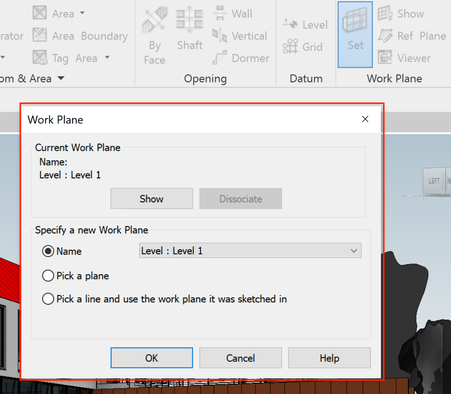

Hi Revit users!
I'm a user experience designer in Revit team. Our team is researching on the work plane feature. At this early stage, we would like to learn about your current experience with work plane.
Your answers to the following three questions will be of great value for us:
  1. How do you currently use the work plane feature?
    • The main use cases in your work? (e.g. set work plane for 2D/3D views, sketching element, placing work plane-based components.)
      • For work plane in views: What do you use it for? How do you feel about the current feature?
    • When you set work plane for the current view, which one(s) of the following are used more frequently?  (Name-drop down list, Pick a plane, Pick a line and use the work plane it was sketched in)img1.png
    • When you change the work plane of an element, which one(s) of the following are used more frequently? (Edit Work Plane, Pick New)img2.png
