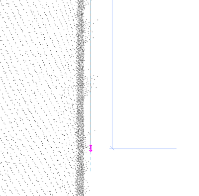

I am experiencing the same issue. I have gone through many solutions, yet I still haven't been able to resolve it.
I have a point cloud and need to create as-built drawings. There is a snap option for the point cloud, but I can't get close enough to the cloud points without having to move away to avoid orthogonal snapping. I've explored various suggestions in this post and others, but nothing seems to work.
