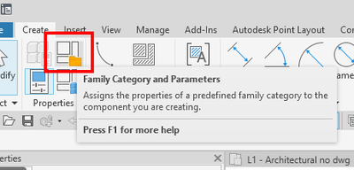

Basam.Yousif
Inside of the profile family, this command
