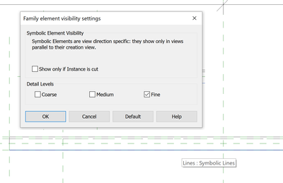

This is a great solution! but i do have multiple situations where is want both options to be shown like below. is there another way to toggle the profiles?WORKS GREAT.png
syman2000
I would add symbolic lines to the round edges so it looks like rectangle profile. Screenshot below illustrate how symbolic line mix with 3d element will help convey what you want to display.
