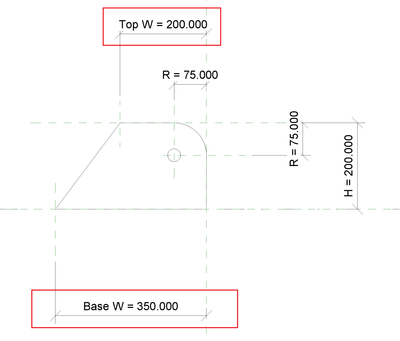

I know how to model in place.
I want to create a family that I can load and edit in place. I have a shape that only needs small changes all throughout my project. i don't want to start the shape from scratch every time. i normal adjustment looks like the image I've attached.

Perhaps the best way is to have profile condition that will adjust according to your need. Here is a sample family you can look at that will adjust the top and bottom width.
