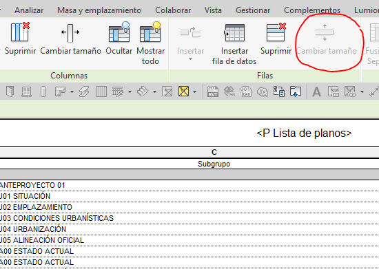

amorap
Hello from Spain
In revit 2018 when you are in a schedule table, there are an option in the ribbon to adjust the height of a row, but for any unknown reason it is grayed out and cant be used.
Hope that sombody can explain how to activate this option.

Message 6 of 9
randiegarcia
thank you sir, it is also available in revit 2017 but it is only applicable in the headers / title but on the row below which contains the description, cost and family it will not be applicable.
