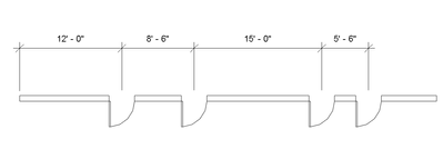

How can I move multiples objects with Dimensions
jysnbnvdz
I know that if you want to move an object with more precision you can make a dimension, then click on the object and then enter the measure in the blue text's dimension, but if you choose more than one object you can't edit the blue text's dimension, how can I do to move multiples objects with dimensions?

Do you mean moving them al the same distance?  If so, place a dimension string to all elements and lock each dimension in the string, except for the one you want to adjust.

edwin.prakoso
You can modify the dimension value even when you select multiple objects.
Do you have any error messages?

jysnbnvdz
thank you so much, but i want to move all the objects that i have selected
Message 6 of 11
jysnbnvdz
thank you so much, it seems the problems was a restricted dimension

aperdueTGQS4
So I have been able to do this for quite some time but recently it's not letting me modify dimensions (permanent or temporary) when multiple objects are selected. Did I mess up a setting some where? I am using 2024.1.

adambikesBVR58
revit 2025 here and it is not allowing me to do it as well
Message 9 of 11
adambikesBVR58
found the fix for move multiple objects with dimension when it is not working. You need to "Activate the dimensions".  See attached
