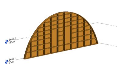

How are you modeling custom casework in Revit? I explore a workflow using Grasshopper in this one...
FacebookGroupMember
681 Views
FacebookGroupMember
How are you modeling custom casework in Revit? I explore a workflow using Grasshopper in this one but not before attempting the same in the Revit Family Editor. Let me know your thoughts!
682 Views
Pretty simple to do as a shaped-edited Curtain Wall in Revit.
A curtain wall with edited profile should do the job. The only part that needs more work is the curved mullions which can be done using an in place or a roof by extrusion.
