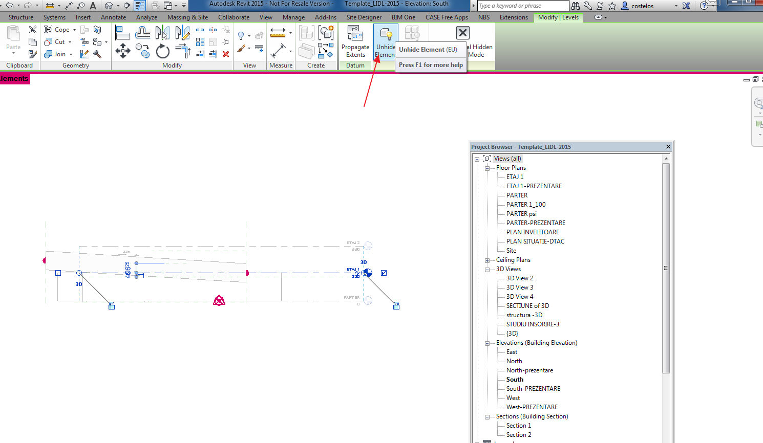

Hi Conbstantin, ok, how do I unhidde if neccesary?
constantin.stroescu

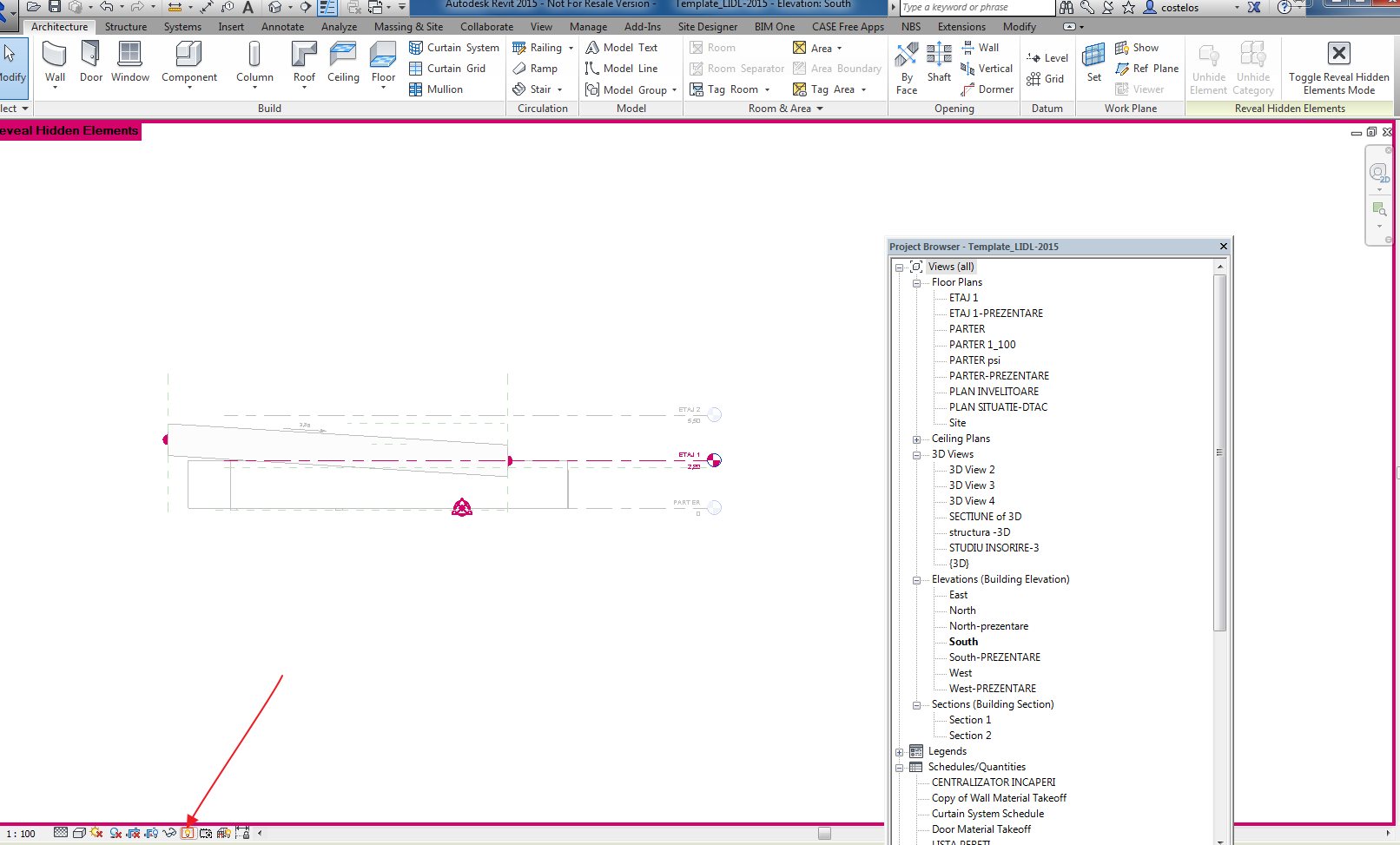

  • from View Control Bar > click on Reveal Hidden Elements (light bulb icon)
  • the Drawing Area halftoned and receive a magenta border (Reveal Hidden Elements) and the hidden element are shown in magenta
  • click on the magenta objects ( revealed hidden objects ) that you want to unhide ant then click on Unhide Element (Modify)
  • then to end the process click on Toggle Reveal Hidden Elements Mode

Constantin Stroescu
Constantin thanks, seems for lines works fine but with the LEVELS I have hidden they don't show up once I go to View- Show Hidden Lines..
constantin.stroescu
 Hide - in the first part and Temporary Hide in the second part....
