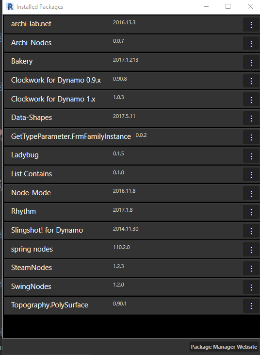

Make sure you have the Packages below installed (overkill but they are useful for other things too).
The text style should be Red Text and the line style should be Red Lines (the style name in previous name is incorrect). if you want to use different style name then change the nodes in the Dynamo script to match.
Below are the snapshots of before and after running the scripts.
Annotation 2019-08-14 164944.pngAnnotation 2019-08-14 165005.pngAnnotation 2019-08-14 165037.png
Thanks for all the help, I really appreciate it. But I can't seem to get it to work, I don't know what makes it mess up
(Dynamo 1.3.4.6666). I takes quite some time, could it be that it can't handle all the text notes? (600+)
