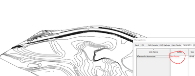

Nachricht 14 von 15
Donovan.MerolaV2SXK
als Antwort auf: tmCL9N6
Thanks for your quick reply.
Yes we have been using this strategy but as soon as you have to issue all models ect to the client, who does not have access to ACC the link is broken & cannot find the surface.
For some reason Revit does not pickup the 3d boundary lines from civil 3d when interpolating from the triangular 3d faces & also does not triangulate accurately where there are sudden drops of elevation levels for example retaining walls ect.
Nachricht 15 von 15
tmCL9N6
als Antwort auf: Seanc9XFAH
But when it cannot find the link, the topo should still be visible?
Revit does not respect feature lines or boundary lines, which makes it nearly impossible to make any usable surface.
