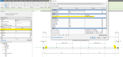

Dear colleagues,
good afternoon - thank you very much in advance for you support in this matter.
I have designed a prefab wall element which does have Omegas profiles placed in vertical which need to be at 1500mm distance each other and 100mm distance from the border. The distance within the Omegas profiles is meant to be calculated from the center of the wall.
I have arranged the formulas and in the family it works perfect (if you change the value in "Lenght full" parameter the wall lenght in the project gets adjusted to that value and the number of omegas gets adjusted in number properly and in the right position.
However if I load the family in the project it misbehave and only the wall get the adjusted lenght, the number of Omegas profiles keep the same of the saved family.
anyone can help?
thank you very much in advance!

RDAOU
@mariozincone
The first thing upon flexing the family is the following so no it is not fine in the family editor too
The idea of locking the Length in a line based family also makes no sense. Length should neither be controlled by a formula nor should it be locked. If it is a fixed lengths simply use a basic generic model

mariozincone
Hi Rdaou,
thank you very much to take time for this. It worked removing Lenght = Formula and removing Lenght full paramenter - now I get the wall correctly in the project, however without min en Max limitation. It is for now a very good start point and I will work further on it to refine. again thanks for your help. kind regards Mario

RDAOU
@mariozincone
in principle you do the following
  • Part 1 - Single panel and/or its posts visible only when length is less or equal to 400 (ie: shortest panel)
    1. Place 2 single profiles for the Panel when Length is less than 4800mm
    2. Align and lock the profiles at a fixed offset from the ends
    3. Give the 2 profiles a visibility parameter Single
    4. Single =  Length < 4800
  • Part 2 - control the array that it always greater or equal to 2
    1. Add a second Integer CL_CTRL= if (count left < 2, 2, count left)
    2. Then select the arrayed posts and associate to CL_CTRL
    3. Repeat the same for CR_CTRL and counter right
  • Part 3
    1. Select one of the arrayed posts (one from each side Left/Right) and associate  with a visibility parameter Multiple
    2. Multiple = not(Single)
If you can you attached your revised Family I can try to help you with it when I have some time
