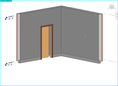

Need to show both concrete curb plan and floor plan; looks fine in plan and section views, but can not joint wall appropriately at corner.  revit files attached too. Thanks!

Wouldn't this be the condition?  Stud Wall on top of Curb Wall - with Exterior Wall Layers extended?
See "Allowing Layer Extension":
https://knowledge.autodesk.com/support/revit-products/learn-explore/caas/CloudHelp/cloudhelp/2021/EN...

Tried … same corner issue if stacking two walls. Unjoin the curb fixes the brick wall corner issue. However, it does not work when angled (acute or obtuse).

Never mind, it works. I should unlock brick and air. Thanks for the help!
