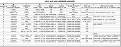

You need to do it in one Key Schedule since Revit have not implemented referencing a key from a key schedule as a parameter in another key schedule.  Below is an example from my project.  I don't show Description for hardware items because they are in specs but it can certainly be done.
