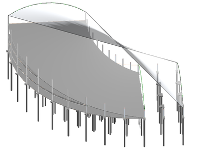

Picture1 and Picture2 shows the issue when I try to create a form with three references. I get an error message which is the item I am trying to resolve. (I already tried displacing the references slightly above columns to see if the voids
intersecting columns was a problem)
Picture 3 and Picture4 shows it working fine with the bottom two references.
Picture5 shows what would happen with the first reference (top of ski slope) and third reference (bottom of ski slope) which isn't the solution I want.

You need more than 3 curves to cover the area nicely. I would have one every two or three bay.

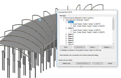

I then tried to load the pattern into my project but got an error that it "Can't make type "Rectangle : Family2"" as seen PictureD and PictureE. Any advice? My guess was that it was something to do with the number of gridlines I have for my mass so I changed them from 15 U grids and 6 V grids to 10 U grids and 10 V grids but it didn't work.
