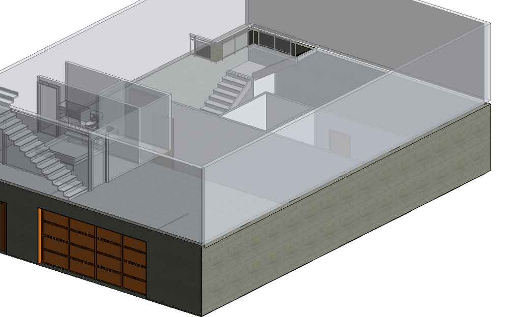

Grayed Walls for second floor in 3d Model
I am trying to view the 3d model of a building but the walls are either grayed out or they are faded so i can see through them to the floor below. Any suggestions?

Wireframe View?  Transparency applied to Walls?
Post a picture and/or the file.
...the default 3D View? Could be corrupted. Delete View and create a new one by clicking on the house icon on the QAT.

Change View Discipline to Coordination.

Just went through this. Phase - Existing Material is Transparent I bet.

how do I fix that? Sorry I'm very new to revit.

Did you see the thread I linked you to in my above post?
You can post your file here if you want.
...set your View Phase Filter to Show Complete.  Does that fix it?

That worked! Thank you!
