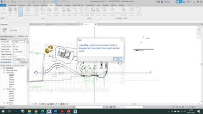

Linked file could not be located. It will be displayed sd it was when this project was last saved
Good evening,
Does anyone know how to resolve this issue?
Thank you:)

Hi to Insert menu > Manage links > and reload the missing link from the folder where you have it.  I usually save links in a subfolder under the Revit model folder and use relative path when linking.

Thank you Toan. It is working:)
