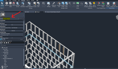

After I click on the Dekton and click Edit Family (Family is a new term for me which I learn on the go), the view of the Dekton opened up. On the material takeoff the Dekton seems like a family:
but on the edit family view, I see that the family is "General model" (image attached below), can you explain it to me please?
