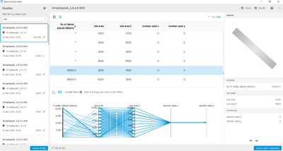

I am Using (GD)Generative Design (21.11.1.0) with revit 2021 (21.1.20.44, 20201109_1530(x64)) using Dynamo (2.6.1.8850)
I have installed all the updates
my system Config -
OS Name Microsoft Windows 10 Home Single Language
Version 10.0.18363 Build 18363
System Model HP Pavilion Notebook 15-bc5xxx
System Type x64-based PC
Processor Intel(R) Core(TM) i7-9750H CPU @ 2.60GHz, 2592 Mhz, 6 Core(s), 12 Logical Processor(s)
Installed Physical Memory (RAM) 16.0 GB
When run in Dynamo all results are produced
When running GD - it able to produce results only results of smaller sites, and shows no value on larger ones.
no value shown on large size sitesno value shown on large size sitesvalues shown on the smaller site sizesvalues shown on the smaller site sizes
dynamo run for a large site size.dynamo run for a large site size.
even if the results show no value , when opened in dynamo , and run, it produced the objects properly.
I have attached a sample of the script for your testing.
please help to fix this issue as i am currently working on large dataset for Generative design.

Hi @neelHJZ84 ,
I was wondering if you have found a solution to your problem? I am facing the same issue with Revit 2021 ver 21.1.20.44, Dynamo Core 2.6.1.8786, Dynamo Revit 2.6.1.8850 and GD 21.11.1.0
