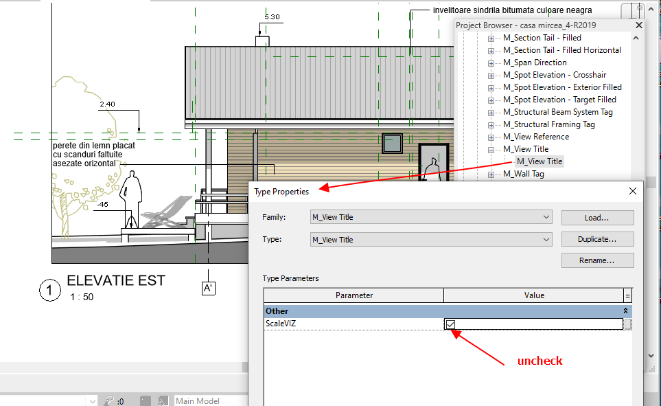

On a Sheet, in addition to some plans with the required scales, I also have a view on the sheet that is a 3D rendering, a rendered image inserted from the "Rendering" section of the Project Browser, and the tag shows a scale.  However, on a 3D Rendering we do not want to show a scale and I want to take out that scale so nothing shows on that line.
How to take out the scale on that View Title?  (I looked on the Properties dialog and also on the Visibility Graphics but so far I haven't found the way yet).

you can do it by creating in View Title Family a new Type with an allocated  Visibility Parameter..
As soon as ETA will be restored I will post the steps that have to be done to achieve this purpose.

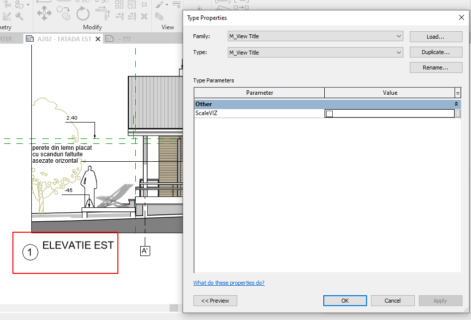

and here is the flow...

I suggest after you make the view title that you add it to your template.

To answer your question: you need to create a view title that does not have the scale in it and create a viewport type that uses it.
