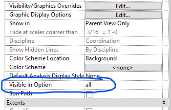

Aside from using Filters, you can set Visible in Option for each View.
