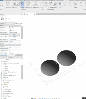

You use the subcategory when you want to switch off in specific views...To switch on/off in all views there is a Visibility type parameter
  1. Scroll in the Project Browser to Floors
  2. Floor 2 >> double clock the family type >>> check the Visibility parameter on
