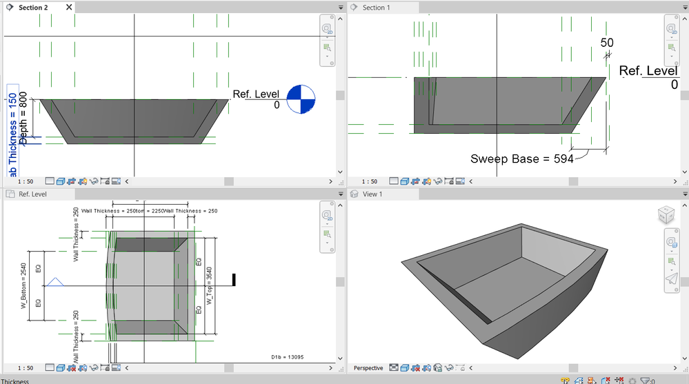

Hi everyone,
I am trying to model a trapezoidal geometric shape (sump of a circular tank) in order to use it in my various circular tank projects..so I've to create a sump's void form witch I can use to cut my slab and put my sump in place. (the details of the shape and its position relative to the axis of the tank are defined according to the sketch below)
I managed to model a fixed shape of my sump according to the above data using a conceptual mass family, but i still have to determinate an exact formula to set parameters of the trigonometric distances D1 and D2 as shown in the sketch witch are function of the sump opening angle of the compared to the tank axis
Do you have any idea how to find the exact formula to calculate distances D1 and D2?

I think that it is not necessary to find those distances, because the family does not need to have round edges on the left side. Those edges could be rectangular. Since the family is going to cut the tank, and the tank is circular, the result would be a void with round edges on the left side.

@REDO10
Not sure why in a mass family...I used a Generic Model for the pit (Nested into a Floor based generic model where a void that cuts the host is added)
Assuming that Wall radius + Top Length x Width x Depth are the user's input to define types, the outcome turned out as follows:

Would that be as per below image?
Do you know how to nest it into a Face or Floor base to add a void that cuts host automatically? Alternatively, you could keep it simple, use the generic family as is and edit the profile of the Floor in the model?

RDAOU
@REDO10
I will answer in reverse order,
4. Where is the center of the raft with respect to the Sump pit? Is it the center of the circle/wall? if it is the latter, simply select the vertical Reference plane passing thought the center and in the properties panel check the box Defines Origin.
3. I think I did not associate the geometry with any parameters. To do that, you need to Edit the Family >> select the Geometry >>> In the properties panel click the box next to material and associate it to a parameter (type or instance is up to you)
2. I am not sure what you mean. All parameters in the family I transferred control an annotation either on the Plan view, section or elevation
1. D1a, D1b D2a and D2b were calculated using the Pythagorean theorem . They control the Reference planes that determine the intersection between the circular wall and the lateral wall see image below:
PS: I have added a void to cut the slab when you load into the project. I will upload the new and port you the link please do not just use it as it is. Try to break it down and reconstruct it to learn how to build the next one on your own.
