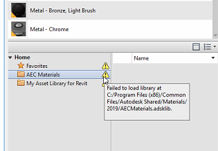

Have never noticed this problem before but for some reason my Material Libraries are playing up.  Having been working on a project all day I wanted to change a wall material and also save some paint materials included in a downloaded Revit file.
Having clicked my 'Materials' button and opened the 'Material Browser' dialog I found that warning signs were showing in the Library pane.  See Fig 1.
Materials 1.png Fig 1.
I tried several times to relocate the libraries and found them, however nothing happened and the situation did not change.  Each Folder with the mouse pointer hovering displayed the message that the library had failed to load!  See Fig 2.
Materials 2.png Fig .2
Anyone know why this behavior occurs please?

L.Maas
Never experienced this kind of behaviour myself but....
It looks to me that the libraries are locked up somehow.
In between work did something got installed/updated (virusscanners etc)?
Are you the only user working with these library files or might another user have approached these files?
Might also be a glitch. Restart Revit or even better restart your computer.

Viveka_CD
Hi @IMCornish
Issue:
When trying to load material into Revit, the following message appears with a yellow triangle (yield sign):
"Failed to load the library at C:/Program Files (x86)/Common Files/Autodesk Shared/Materials/2019/AECMaterials.adkslib."
Yellow triangle in Materials Browser showing 'Library failed to load' in Revit
The materials will not load.
Causes:
The material libraries may have been created in an older version or different versions of Revit are accessing the same material library.
Solution:
To successfully load the material library, try the following:
  1. Close all versions of Revit to release the lock on the library,
  2. Reopen Revit to use it
  3. Test if the library can be accessed when running Revit in a Windows User Account with administrator rights
  4. If it works, log off and log in with the "regular" Windows User Account
  5. Run Revit again with the proper Autodesk credentials
  6. Copy the library to a support path only Revit will access.
