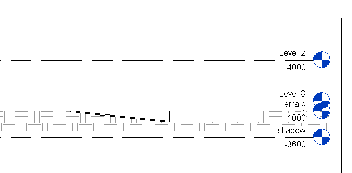

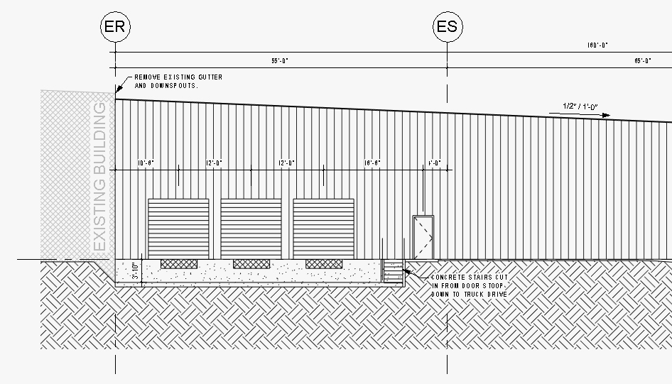

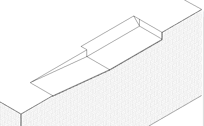

constantin.stroescu
something like this?
Constantin Stroescu
Message 6 of 10
I've made a screenast on this subject...
