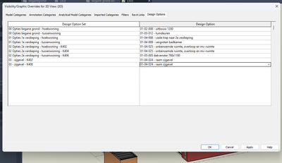

I have different design options for various parts of the building. In the Visibility Graphics dialog, I can select these options easily, but in the workspace, I can only activate one at a time. Even when I select 'Export only visible in view' in the IFC export dialog, I’m unable to export all the design options I chosed in the Visibility Graphics settings.

The design options are correctly configured in Visual Graphics, and the selected design option is active in the Visibility/Graphics dialog.
I also attempted toggling the workset between active and inactive.
The "Export Only Visible in View" option is enabled, and the Phase Mapping in the IFC export settings is correctly set.
After multiple tests, I noticed that when design options are set to Automatic in Visual Graphics, the IFC export includes the Primary Design Option. However, when selecting a non-primary design option in visual grafic, none of the design options are included in the IFC outcome .
