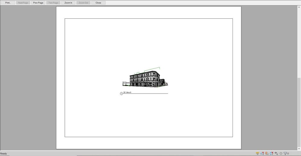

Also, I thought I would share what results I get from exporting my regular 3D view to see if that would help since this is the result I need to get with the 3D camera views. This first image is what my 3D view looks like on the sheet;Capture4.JPG
And this second image is the resulting export preview. I know the drawing is cut off but I'm showing it because it appears just fine when I export it unlike my camera view - it's really weird.
