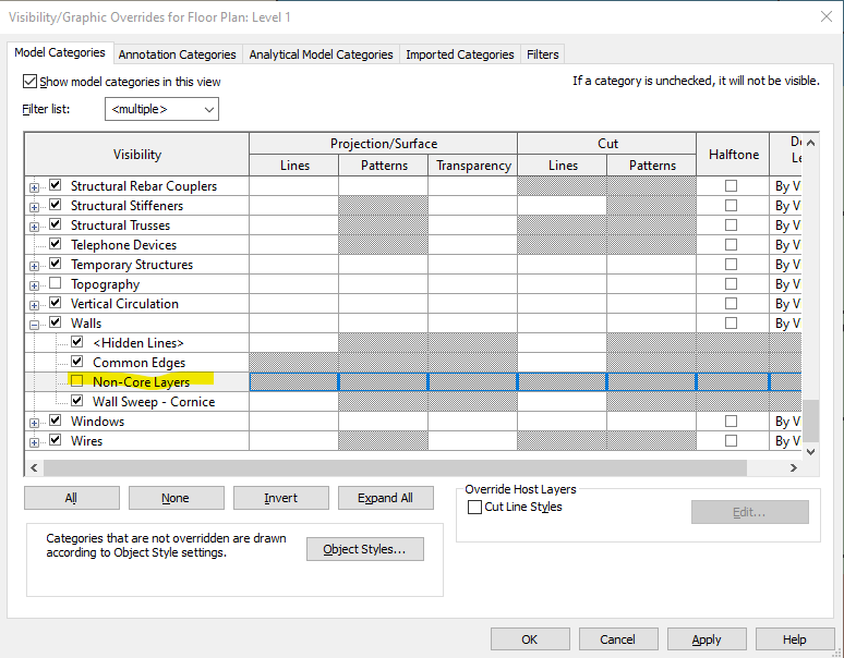

We want to show our walls with a solid grey hatch in plan views, but in sections we want to show a diagonal line hatch. I haven't found a great way to do this yet. I set up my "Metal Stud Layer" material to have a solid grey hatch, and made a filter in my sections to show any walls with the "Metal Stud Layer" structural material as a diagonal hatch, but the problem with this is that it overrides all of the layers in the wall, not just the stud layer.
Any ideas out there on a good way to set this up?

@jmartucci2  Which Version of Revit are you using? Revit 2022 now supports hiding Non Core wall Layers.  this would work with the Coarse Scale Fill pattern.
Alternatively, you could just use the Visibility Graphics Override, to change the Cut Pattern in the Plan or Section, to the desired pattern.
If you don't want the override to affect all walls, then you can create a Filter to select the walls you want to override.
