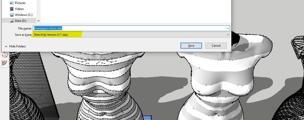

Openthe SKP 2021 file in Sketchup and save it as Version 8... then it will import/Link into Revit

Revit shouldn't have any issues with non-manifold edges (which result what you referred to as Leak / Water tightness).  This happens when users model geometries using disjoint surfaces rather than extruded solids which is not uncommon.  I have run across so many of such Sketchup models and had no issues importing into Revit. As a matter of fact the Mannequins in the image I shared earlier are actually a Non-watertight object...
