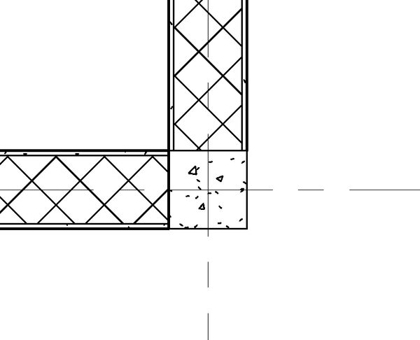

Im really new to revit.
How do make the core and plastering work properly in this joint.
In wall joint setting i get only 2 settings

Wall layers join based on the following:
  1. The Layer function defined under Type Properties >> Structure
  2. The Layer placement within the Core or outside the core
Example Below:
Type 1:
  • Plaster layer - Function: Finish [5] - Placed outside the Core
  • CMU Layers - Function: Substrate [2] and placed in the Core
Type 2:
  • Air Gap and CMU Layers - Function: Substrate [2] and placed in the Core
  •  Concrete Layer Function - Function: Structure [1] and placed in the Core
Those are not universal settings, sometimes one combination doesn't work and one would need to try another

Is there a way to get the plaster to go around the structural column ?
Nachricht 5 von 6
RDAOU
als Antwort auf: Anonymous
@Anonymous
If it Wraps around the column meaning the column is entirely embedded in wall...
Option 1:
Reduce the size of the column a value = plaster thickness? this way when you join geometry the wall plaster will wrap the column
Option 2:
you can edit the column family and add a plaster layer (another extrusion)
Option 3: (Only if you are familiar with Parts)
Converting the wall to parts allow you to control layers separately  by enabling shape handles / grips
