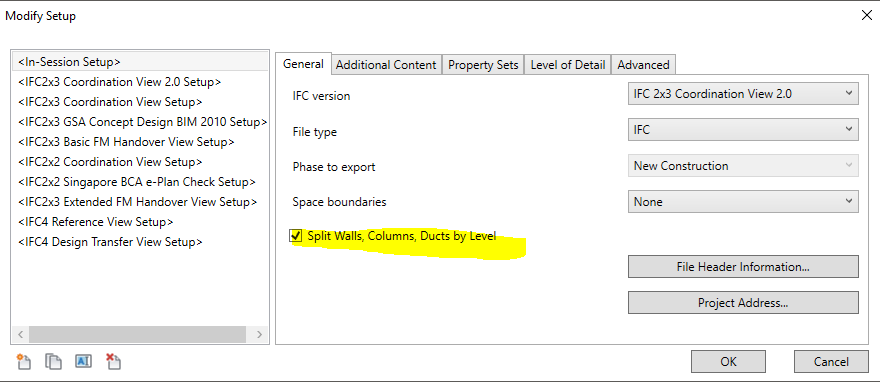

If you set the IFC Export to Split by Level then you can open the IFC, turn to an 3d side view and delete elements on other levels fairly quickly.

Hi @ToanDN,
thanks for the quick answer.
Actually everything is modeled in Revit resprecting the levels. I do not understand where you are deleting things. Do you mean you delete elements i the IFC File? what Software do you use for this? Or are you deleting in the text editor?

Yes I mean open the exported IFC file in Revit, switch to a 3d side view, and delete things not on the level you want.

If i understand correctely your workflow is the following:
  1. create your model in Revit
  2. Export to IFC with the option "Split Walls, columns, ducts by level"
  3. Open the exported IFC with Revit
    Revit will create a *.rvt file transforming all the IFC elements into Revit elements by using the settings in REVIT --> OPEN --> IFC Options
    in this settingsdialog you can choose the template used to open an IFC and Create a Mapping between IFC Class Name and IFC TYPE, Revit Category and Revit Subcategory
  4. in this created Revit File you delete all the stuff you do net need/want
  5. Export again to IFC to
Is this correct?
I think this is quite risky since neither my IFC Export Mapping table nor the import mapping table are 100% accurate ( it's a learning process and it needs to be changed on every project), so i do not feel that i control whats happening.
In this case i prefer to create individual Worksets and export with the option "export only visible elements"

Let's say you have exterior walls or structural columns span multiple levels.  How would using worksets split them up?

Hi @ToanDN,
I totally agree. In the BEP is defined that we share *.rvt & *.ifc and that even in Revit all elements have to respect the correct level assignation.
so in this case the best way is to create Worksets for the individual Level export.
thanks a lot for the discussion.

Is there are update regarding this Topic? Any suggestions? What about Revit API IFC Exporter?
Solution suggested by @ToanDN is a no GO, because:
-there is additional procedure to import/delete/export elements - very time consuming
-there is data Loss during re-export of IFC from already exported and re-imported IFC into Revit
