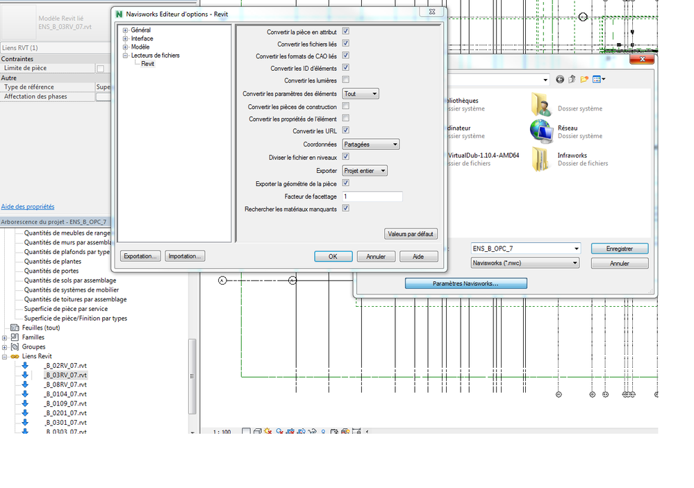

Hello Everyone,
Is there any way to export multiples linked RVT files into separate NWC files. Because I can only include the linked file into one NWC file.
FYI: We use a plugin to manage all our linked files, which updates and downloads automaticly all the updates of all linked files. But it saves the file on our serveur with a very very very very long directory for every independent rvt file. So I can't use the batch utilities in Navisworks, it will take too much time considering that we have houndreds of them.
So if anyone has some other ways to do it, thanks in advance. And Happy new year to everyone.

Meanwhile, please check this article: Linked files not included when exporting to NWC file format which discusses a couple of workarounds.
Regards,
SteveKStafford
Have you tried exporting By View? This only exports what is visible in a view. Set up unique views that only show one linked model. Export each individually.
Steve Stafford
Sahay_R
Create separate 3D views. Turn off worksets / categories that you don't want to see. Putting each link into its own workset would be helpful. Export out to NavisWorks. Lather, rinse, and repeat.

Thanks for the tip, So the premary solution would be creating views for each linked RVT files and then with the help of Dynamo, we can export all the views into NWC.
CICAD_BIM_Utilisateur_01
Thanks for the tip, we are working on the Dynamo nodes for the batch exporting.
