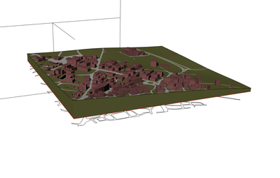

Hello, I need to make a topography on revit. I have already a topogaphy on rhino. I wanna import from there. When I tried to import the topography looks so weird. I really don't understand Still can't figure out where I went wrong. I'm gonna add a picture too btw. I need to do it for my project. Can you help me please?

Looks like you used a DWG import. Consider using Rhino Inside Revit, Looks like your Rhino surface is one complete surface. In any case it is worth considering using Grasshopper. You already own Rhino so you own Grasshopper and you just need to get Rhino Inside Revit addin at no extra charge. I know this is not EXACTLY like your surface, but this example will get you started.
