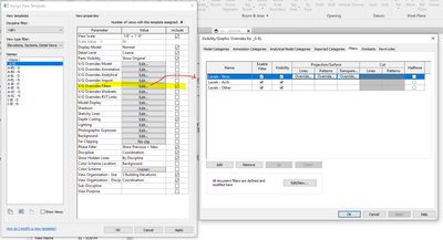

levels have 2 check boxes, one for Structural and one for Building Story. in our models i have built in filters to turn on/off levels based on their use selection. structure levels are always check with Structural, Architectural levels are always checked Building Story. If our MEP needs to place a level to distinguish something unique for them, they Uncheck both.
then in our VT's they can have the filters on or off depending on the need.

Yes I was playing with those options when running some tests.
But regardless of whether those boxes are checked or not, a user can still use that level as a associative datum which can lead to elements being accidentally modeled in association with it instead of the floor levels.   So I really push for architecture to not create levels for t/o steel, stair landings, frost depth, etc.
