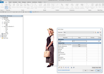

Here is what I'm stuck on how to change / add / create new when I am in the RPC - Women 3d family - how to make more....
First I open the family
change it to realistic, then select family type properties and window opens
I want to know how to add to this...
Render Appearance Properties
Which has these options...
And the Render Appearance options window which has multiple options to select from
So, I have a few other images downloaded from ArchVision, so how do I add them?
This family that I've used is OOTB, so there was 6 different type names with images.  I have a download folder of the ArchVision Dashboard images.  None of the downloaded images I have are in these pictures.  I wanted to have more for different themes....
