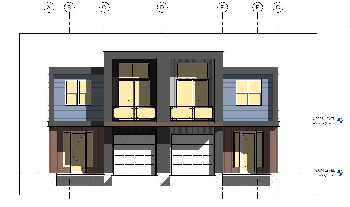

Hello all,
I've linked a model and then setup the elevation views but after selecting 'By Linked View' and choosing the corresponding view none of the annotations such as dimensions, text, symbols or filled regions appear.
What's odd is that the floor plan views came in with their respective annotations.
I've included screen shots of the source file and then the linked view.
1,323 Views
It may be that the two elevations are not parallel - they have to be to display annotation objects from the linked view.

Check the project coordinates of both projects
Sahay_R
Check the view template controlling the elevations of the host project. Are there any annotation categories turned off in the host view? Also check them for the linked view.

775cforsyth
Thank you for your input.
My mistake was in forgetting to link both models into each other. I had
only linked the second building into the main file.
Ugh, these late nights are taking its toll.
