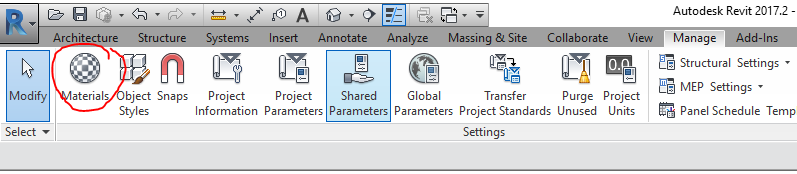

Graphics are not loading or no options provided. I had to fix my graphics card and made sure I have the system requirements for the graphics and all seems right, with enough space being a new laptop. Followed a couple troubleshooting tips on Revit website but still unresponsive. Anyone come across this? Some help would be greatly appreciated. My Revit is a student version as well. materials problem.png

Message 2 of 11
ennujozlagam
hello, try to untick your "use hardware accelerations" from options > graphics > graphics mode and see if helps. thanks
Message 3 of 11
adhmadcreations
Hi there thanks for the info. I have tried that and it still doesn't want to load. I tried turning it on and off a few times. Cheers
Message 4 of 11
Do you mean there was nothing happen when you clicked on the Material button?
Message 5 of 11
adhmadcreations
Yes, the button turns blue and sometimes loading icon... But nothing at all. Have tried all Revit tips and troubleshooting on the Autodesk website...
Message 6 of 11
Does the Materials window open when you click on Manage panel > Materials button?
Message 7 of 11
adhmadcreations
No, just tried it, nothing showing.
Message 8 of 11
Maybe it's time to uninstall/reinstall the program completely.
Message 9 of 11
adhmadcreations
Ok thanks for your help 🙂
Message 10 of 11
adhmadcreations
Have uninstalled/reinstalled, still not working! Would it be because it is a student version?
Message 11 of 11
adhmadcreations
Worked in the end, had to again reinstall Revit without the Antivirus and Firewall on, as well as UAS settings turned off too, after a long day wait my materials library finally downloaded.
