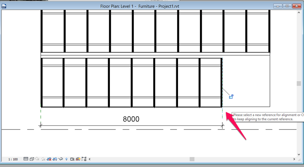

I used the line to pick start and end point on roof.
In my case I cheated a little as the endplate was falling between lines of the line base family. So after initial snapping I had to stretch the line (+/- 2 mm) to get the end-plate over the edge of the roof. Blue dot is the end point of the line of the family. Other red arrow points to edge of the roof.
These are minor adaptations/finetuning to the family.

I takes me a few clicks to place the system
Selected the family and use pick line and place on face to select edge of roof.
And click, follwed by the cut command....done
The length parameter in the preprties panel is indeed greyed out.
Need to go to a certain length? One or more edges (e.g reference plane) and for example the align tool it easy to adapt the length of the sytem to a fixed length.
My take on this quite manageable.
