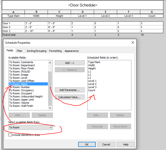

Hello guys, I have the following problem. I want to create a schedule like this on the attached screenshot - with levels grouped by columns, not by rows. I tried to create a new parameter, but it was impossible to chosse "Level" type. Is there a possibility to to that in Revit?

Message 2 of 18
Here goes:

Hi ToanDN, Thank you for sharing this. Just want to ask you a question "how about if i want to add Room Name (location of doors). What could be the parameters? Please help. thank you

Message 5 of 18
See the screenshot and let me know if it answers your question from the PM.

hi ToanDN, Thank you for your reply. sorry for late reply. I followed your instructions but i dont get it right. I really dont know where i made mistakes.
When i add to " to room: name" my locations of door doesn't appear, followed your screenshot door schedule but if i changed sorting/grouping instead of " type mark" to " to from room: name: room names appeared but my problems the door schedule becomes individual and not groupings at all. any help can give is much appreciated. please see attached. thank you.
Message 9 of 18
If you want to show Room fields then don't group the doors in your schedule.
Message 10 of 18
BIM_Dreamer
is there a way to group the doors with door locations? thanks
Message 11 of 18
You can add door location to one of the grouping option from the schedule.

Message 13 of 18
Screenshot and 2016 Revit file attached.
Message 14 of 18
BIM_Dreamer
Hi ToanDN, i opened your file and look at your plan but i dont see any room number , where did you gent your room number. And we dont used room number we used room name here.
Message 15 of 18
The rooms are there, I just didn't tag them.  Same principle whether you sort by Names or Numbers.
