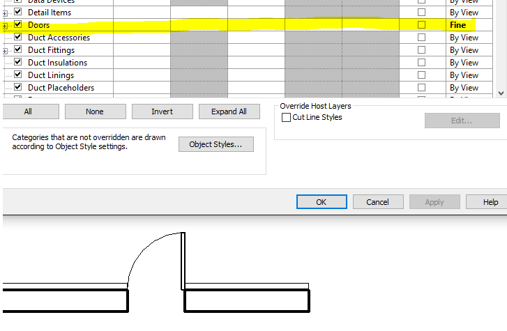

As a workaround, you can take advantage of the Family element's Detail Levels function.  The attached under the assumption that the diargrams in Coarse detail level.  If other floor plans can be in Medium or Fine, there is no further action needed.  If they need to be in Coarse, then you can override the Door category to be Medium or Fine and the dots shall dissapear.  There maybe some tweaks needed to get your door graphics look right across the detail levels but I think they can be done.

I tried the coarse/medium/fine and that worked! So, technically it would be possible to have three different versions of a door - coarse for fire, medium for acoustics and fine for regular. I feel that it isn't a very expandable idea but would be useful for a small project that I was working on by myself.
