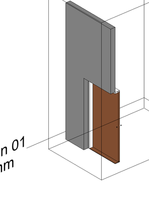

The door opening isn't missing on my end when I Export to IFC and Link the Exported IFC back into Revit.
I opened you IFC and the opening is fine, but the door is at the incorrect plane.  Is that what you mean?
By the way, Export your file to IFC from Revit 2022 gives the correct model, matching the original.  I blame the Revit 2021 IFC exporter.
