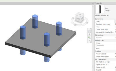

Hello, mates.
As the title says, I'm wondering whether family data has an auto-void/clip function or not.
Before, I took a look at the Revit Structural Project sample data (Japanese ver) by Revit 2021 and found that the one of the nested family(pile) has (probably "has" is a wrong word to choose) a void which is located in the same position as the pile (refer to the pics "001" and "002").
But I once created a mere cube with Extrusion in a rfa file whose template is "Generic Model" and insert it into another rfa file like the first one, I couldn't make hole in the host family (refer to the pics "003" and "004").
Does anybody know reason for it? I'm still not sure why it doesn't make it.
I'm waiting for your answer and if you do it, I will respond to it as soon as possible.
Thanks.
Regards,
001_Nested_family.png002_Applied_hidden.png003_Nested_family.png004_Applied_hidden.png

It's a limitation. You can't cut family geometry with a void in a nested family.  You can cut Project System Families with a void in a loadable family (if Cuts with void when loaded is checked in that family).

If you want void nested family, use face base family and have void cut through the face base. Once you load to your main family, it will cut any surfaces.
Message 6 of 14
I think what your screenshot shows is a joined condition.  You don't need a void in the family to do that. Just use the Join Geometry Tool on the Modify Tab in the Project environment.  Join Geometry will remove volume at the union of 2 geometries. Use Switch Join Order to change which geometry gets volume removed from it.
Help | Join Geometry | Autodesk
BTW: if you want to verify whether or not it's joined, use the Unjoin Geometry Tool and select the pile.

What exactly I want to do is mainly three.
One: eventually, I want to make a sheet with a front view of a bracket model in a project file composed by at least a main family (multiple plates) and bolt family.
Two: it would be great if I "DONT" use void family to make holes on the plates because it needs less efforts to create a hole model until making a sheet but I want plates volume to be precise given holes for bolts.
Three: Bolt families don't need to be shown in a front view when I make a sheet with it.
Therefore, I was wondering whether there is a way to make a hole when I insert, let's say, Generic family into another family/project family but host family is also Generic Model.
I think it's very lazy of me but was eager to pursue more efficiency.
Thank you for reading my sentences till here.

are you trying to model structural connections in the family.  You don't need to.  Revit can do it for you in the Project - automatically and parametrically. Very BIM.
https://help.autodesk.com/view/RVT/2024/ENU/?guid=GUID-C6E1D473-1B03-4E6F-9CAE-3354FCAE7790
Example of base plate (structural connection) between column and footing:
NOTE: Concrete Column's Material for Model Behavior is set to Steel:
https://help.autodesk.com/view/RVT/2024/ENU/?guid=GUID-8573C22F-191B-4954-9C29-00A245D39EC4

It is possible. I use these family if I want to cut a hole in a family instead of using each individual void. See attached
Message 14 of 14
Yes you can join generic models together in the project and holes will be created automatically.  They don't need to be face based families and they don't need to have any voids.
