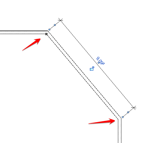

I am trying do make a dimension at an angle like this:
But mine is not at an angle:
What am I doing wrong?
Thank you for your help.

Use Dimension Aligned > use TAB to cycle through over the corners till the Vertex is selected , then go to the other corner and proceed the same way...1.png

and a short screencast that shows how to do it....

This did not work for me.
However after I drew one single wall it worked fine.
When pressing the tab key, I never get the little blue square, like the one shown in your video.
How did you do it?
@Anonymous with higher resolution monitors the dot is very, very small... I move the cursor away from the corner a bit, and you can barely see the dot.
Works better if ThinLines is turned off, but can get lost in the wall cut if you don't zoom in enough.
