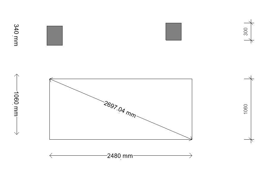

Corsten.Au
Hello
It will be great to change the dimension style to get that result..
but  If its one off then a line based family can be easy to use..
line based family, annotation text mapped to dimension lengthline based family, annotation text mapped to dimension lengthin project, use annotation , pick two point to get that dimension.in project, use annotation , pick two point to get that dimension.Screen cast uploaded here.
