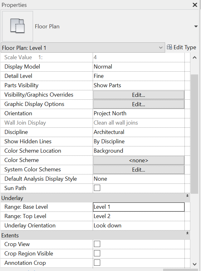

DWarren_CPL
@MostafaElashmawy wrote:
Or may be you have an underlayed view that have similar walls at same location.
Here are the properties of the view.
