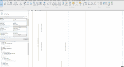

A colleague is setting out the grids for a new project. She set her dimension accuracy to a (in my opining ridiculous) small length. Centimetre with 12 zeros behind the decimal. This had brought to light an accuracy problem in Revit.
Even though the grids were placed with rounded length 810cm and 630cm, when placing the dimensions, the length is slightly off.
What's weirder not all dimensions have this, and using Global Parameters (blue ones) doesn't help either. (Sometimes deleting the dimension and recreating is does help.)
The project Units are set to millimetre with zero decimals. But changing this doesn't increase the accuracy.

Attach the Revit file...you can copy the grids and the dimensions to a blank model if you do not or unable to share the model.
PS: was that value a manually input? if it is the case you will need to reset the precision and replace the dims...Revit has a 6 digits precision/accuracy so that might has something which is contributing to it ... trying to manually re-enter the rounded figure to reset the decimal 0 wont work because Revit will ignore such negligible inputs past the 6'th decimal (see below GIF)

K ... I had a quick look at your file and there seems to be something very odd with the dimension style. I used the Dimension Style 2.0 mm - Transparent / Axis 0,0cm control and it seems to work fine...
The other Dimension Style names 0.0000 seems to have something wrong with it
