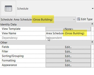

In my template file I have set up a few schedules. (Ok, maybe more than a few. And maybe I copied some of them from Revit OOTB. I'll customize them later...) Among these are some Area Schedules. I also have set up a couple custom Area Schemes. And now, in a project file, I want to create an Area Plan to place the Areas from the relevant Area Scheme. However, I have no idea which schedule applies to which scheme, and I'm not sure I connected each Area Schedule to the correct Area Scheme Smiley (wütend) I know I can delete these in my template and make new, correct schedules, which I may need to do. For now, this is what I'm wondering: Is there a way to identify from which Area Scheme this schedule was conceived? I don't see any way in any of the fields shown in the image.

ToanDN's workaround works! But sometimes it can take a while. Definitely should be added to Revit OOTB - what would be best & simplest would be just an additional note in parentheses in the schedule's 'Fields' properties indicating what Area type (scheme) is being scheduled. This is needed because Areas from different schemes function as completely different Area types.

It already exists - parentheses too. I think since 2002.  No?

@barthbradley - yes, it's included in the view name when you create a new schedule - but, if someone were to go in and rename the view, and delete the "(Gross Building)" part, then I don't think that info is shown anywhere else. You then have to use the "show in model" technique or other in order to figure out what area scheme is used for the schedule. Yes - you could be careful to keep the area scheme info in the view title - but especially with multiple users, you never know when someone will rename the schedule. I was thinking this info should be shown somewhere where it can't be deleted - like in the properties window, under "fields" ?
